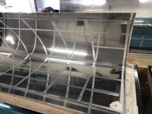

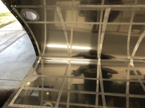

Used a dremel tool and a 120 grit vibrating pad to roughen the mating surfaces inside the skins. I taped off the lines and made quick work of it. Dimpling of the skins was all done on my DDRT2. None of the number 8 dimples were done with a squeezer per plans.
Mating Surface Roughed
Fuel tank surfaces
Fuel tank surfaces
