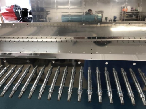

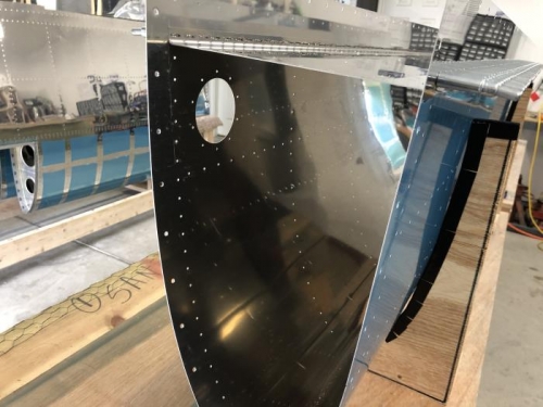

Countersunk all the skin holes to baffle except every tenth rivet. Every tenth rivet is left unsunk for alignment. These are completed after all proseal and all other rivets finished. J Stringers for both tanks are completed and drilled.
Baffle in place
