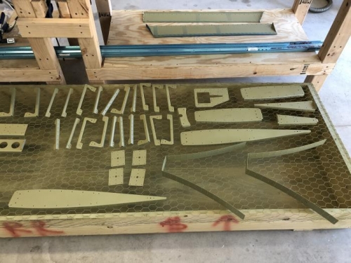

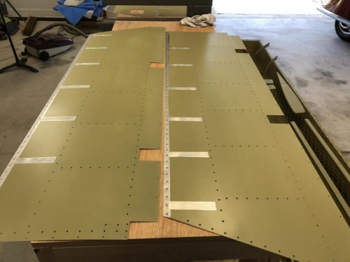

Elevator Priming
All of the elevator parts took 18 fluid ounces of Akzo Noble primer. I primered the elevator skins since this section is horizontal and I feel water can sit this area and not drain as well as the vertical stabilizer.
