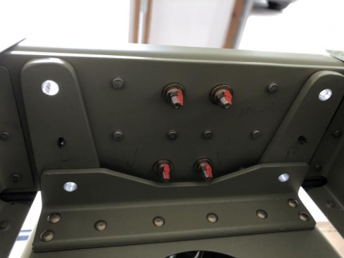

I used a square and a 12 inch long 1/4 drill bi to reach the bottom holes on image 3. Keep the holes perpendicular to the HS stab.

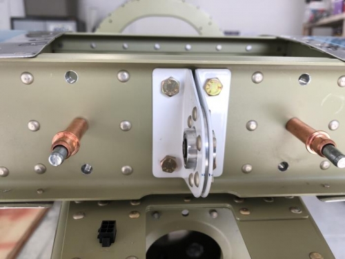

Front bolts

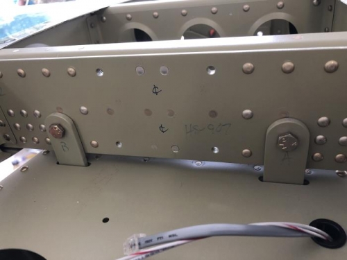

Rear holes drilled
Inside look
