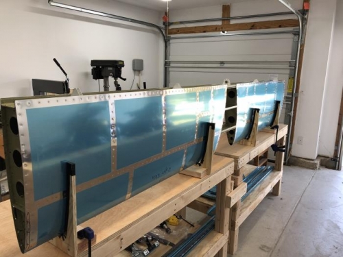

Riveting Skins
The only hard part is riveting the 905 inspar ribs as last. You can't fit the squeezer in there and it calls for -7 and -8 rivets! Go slow on lower air pressure with a tungsten bucking bar and everything works out great.

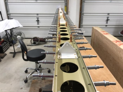

Rear Spar Clecoed
Inspar Ribs
