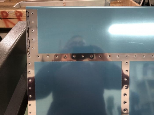

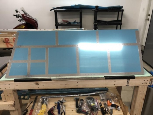

HS Skins dimpling

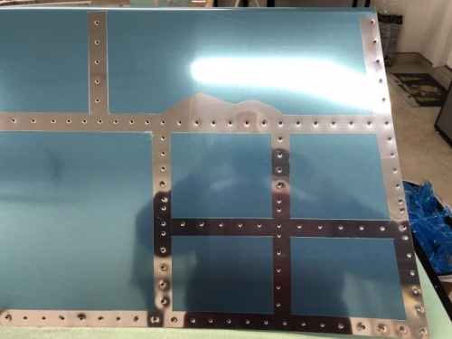

When dimpling the right and left stabilizer skins, make sure you make a left and right. Don't get lazy, mark the holes with tape that do not get dimpled. ONLY the inboard top holes don't get dimpled for the fairing.
Right stab dimpled
Non dimpled area
Close up of dimples
