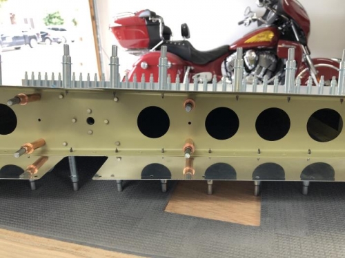

Front spar riveted on
This part was straight forward, except I had on rivet shaft break half way. I had to cut it off, punch the center, then drill it out with no. 30 bit. It wasn't too difficult, but frustrating.

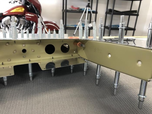

counter balance rib
ribs waiting for LP4-3 rivets
