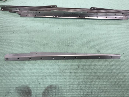

Used the DRDT-2 to dimple the rudder skeleton. I used the Clevelan sub structure dies to dimple these. They do make a difference when fitting the dimpled skins. There is absolutely no gap and the dimples nest perfectly.
