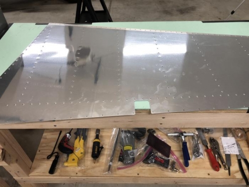

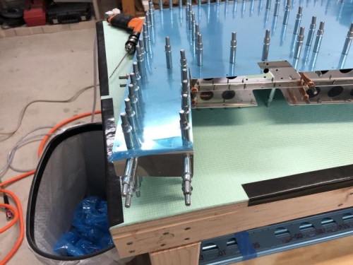

Brief Description:  Removing clecos to rudder
Removed all of the clecos and dimpled the rudder skins. I will use the Cleveland substructure die on the skeleton. I also ordered the special CS4 rivet die set from Cleveland to rivet the last hole on the top of the rudder skins for the CS4 flush mounted rivet. This rivet is 120 degree instead of the standard 100 degrees.
Clecoed Skins
Clecoed Skins
removed bluing
removed bluing
Dimplied Rudder skin
