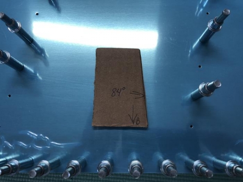

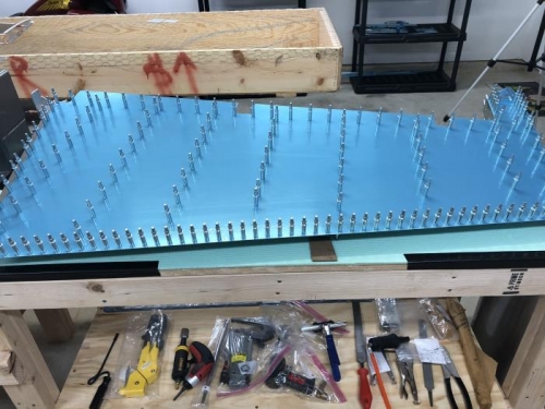

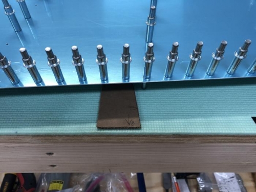

Clecoed all of the rudder skins to the skeleton and drilled the trailing edge. I created a template to act as a drill guide so I can drill perpendicular to the chord line. This angle is approximately 84 Degrees.
Clecoed rudder skin
Drilling template
Template closeup
