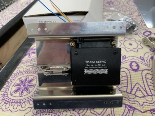

Brief Description:  Constructed Aileron Trim Module
Trim module fits very nicely into the opening. I replaced the mini molex with a CPC connector. This is a much better connector and wont become dislodged. I had a very difficult time tring to insert the male pins into the molex even though they were properly crimped with the correct tool.

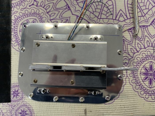

Bottom of Trim
Bottom of Trim

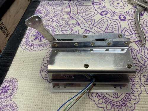

Correct Placement on Hatch
