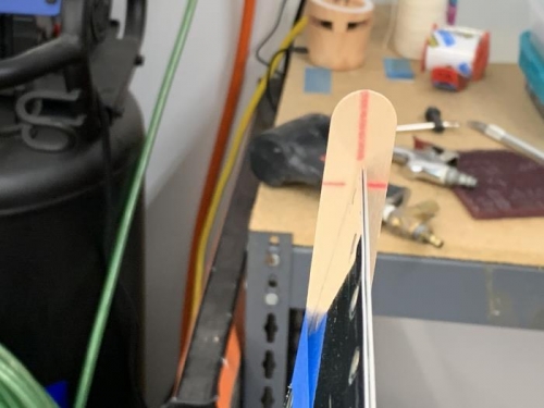

I used the Cleveland trailing edge rivet set to squeeze the rivets. I didn't put the trailing edge on the table, but instead used an aluminum angle drilled for the trailing edge to keep everything straight. This worked very well as you can see with the laser alignment tool.
Laser Straight
Laser Straight

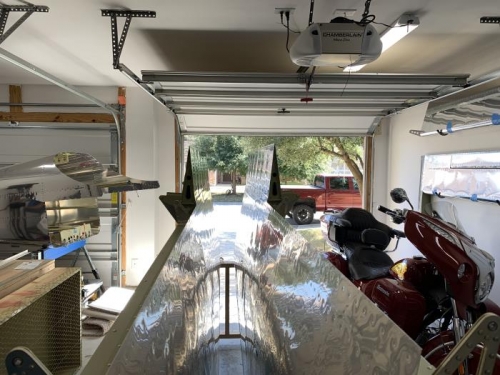

Right Flap Mounted
Right Flap Mounted

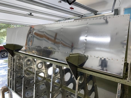

Both Flaps On
Both Flaps On
