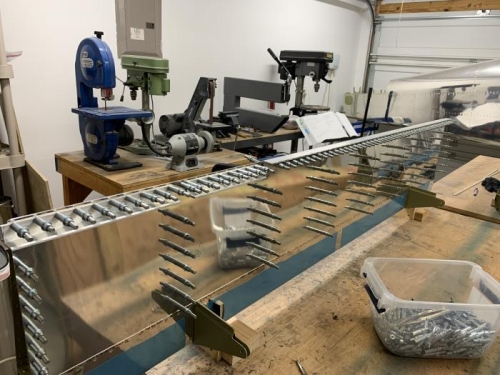

Brief Description:  Clecoed Trailing Edge of Right Flap
I placed 3M tape on both sides of the trailing edge wedge strip. I waited two hours before removing the tape so it would not peel up with the backing strip. I didn't use the weighted flap on the table. I found it more effective to cleco alumininum angle to the trailing edge to make a perfectly flat trailing edge. This works great.
Right Flap Trailing Edge
