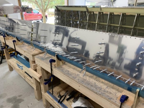

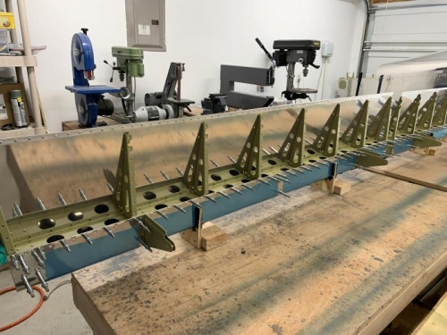

Riveted Right Top Flap
The plans state to use back riveting on the last two rivets on each rib. I found that my extended thin nosed yoke for the squeezer fit right in there. No need to back rivet and everything remained true with no distortion.
