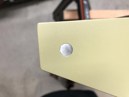

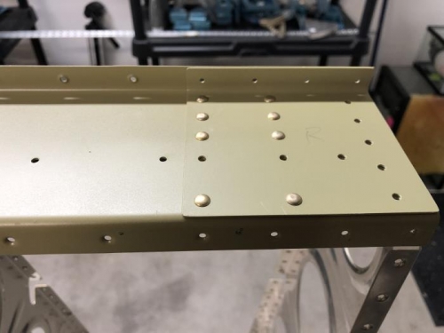

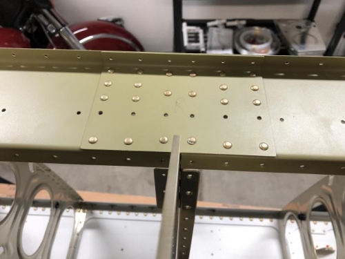

Riveted the rear wing spars to the ribs. Some of the rivet had to be shot with the gun instead of the squeezer. The critical hole was reamed with the 3/8 reamer purchased from Cleveland Tools. I wanted to make sure the hole was drilled very perpendicular to the spar. I used a small drill press mounted on the bench with the spar leveled.
Inboard rivets
Inboard rivets
Outboard rivets
Outboard rivets
Critical Spar Hole
Critical Spar Hole
