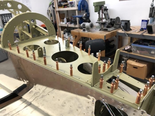

Brief Description:  Rear Deck
Most of these rivets are easily squeezed, but approximately 8 rivets need bucking. The rivets closest to the large elevator mounts are the hardest and require at least a 5 inch rivet set. I had to drill out 3 rivets because of the bucking bar slipping.
Deck Clecoed in position
