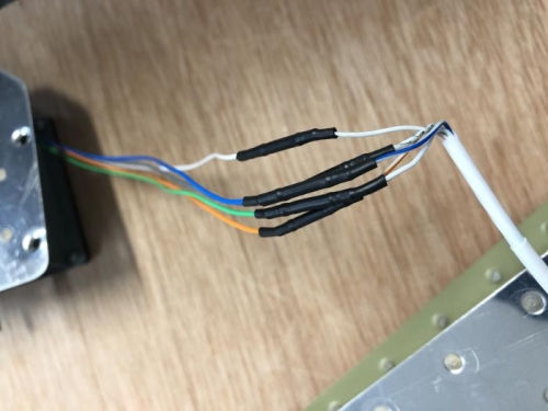

Brief Description:  Trim Servo Wiring
I replaced the mini molex on the trim servo with d-sub pins. I used the existing wiring harness and just replaced one of the mini molex connectors with the pins. This is a very solid connection. I will use the mini molex on the end of the harness since this was already crimped in place for the fuselage connection.
D-Sub Pins with heat shrink

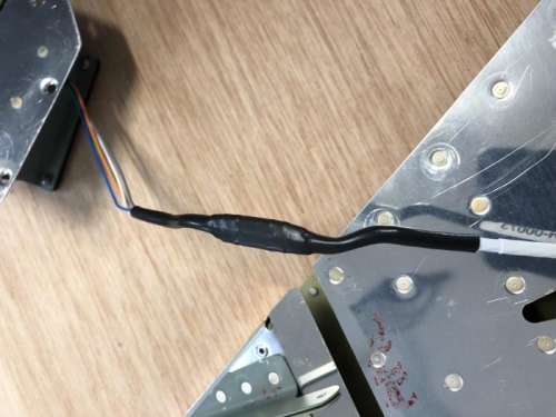

Bundle covered with heat shrink
