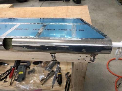

Brief Description:  Elevator rolled edge

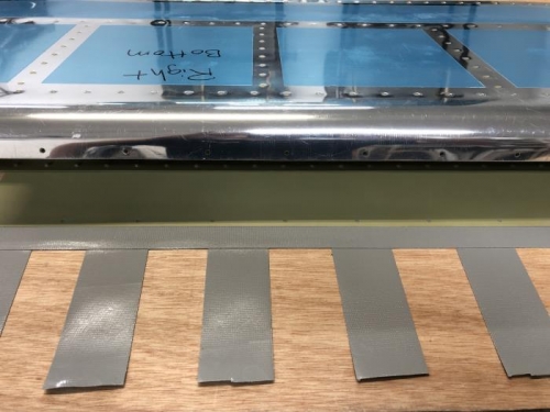

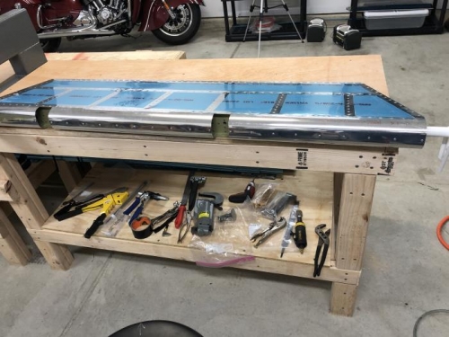

Rolling the leading edges took some elbow grease, some Gorilla Tape, and a 3/4 pipe. Just take your time and use some channel locks with the pipe. I found the tape worked great and I did not have to use clecos. No pillowing of the edge. I did break the top edge a little more than the roller tool could.
Use of Gorilla Tape
Use of Gorilla Tape
Finished Edge
Finished Edge
Some nice rolls
Some nice rolls
