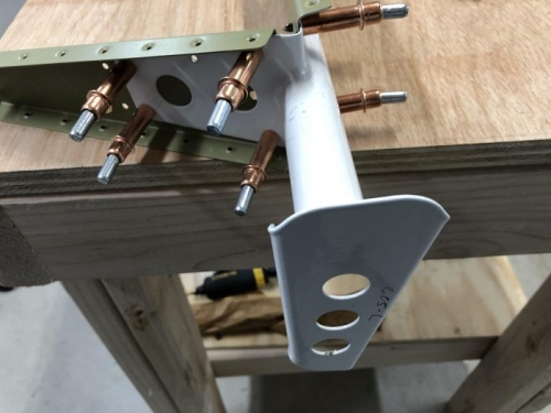

Brief Description:  Elevator Ribs
Some of the tabs for the inboard ribs were are to reach with the squeezer. I had to use the rivet gun on some of those. My trick is to put some masking tape on the head of the 470 rivets so the rivet set does not bounch and slide off as much. This works great.
Counterbalance ribs
Counterbalance ribs

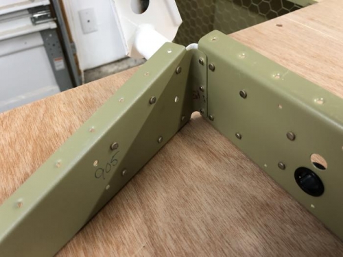

Elevator Control Horn

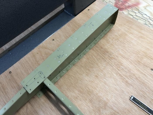

Inboard rib
Inboard rib
