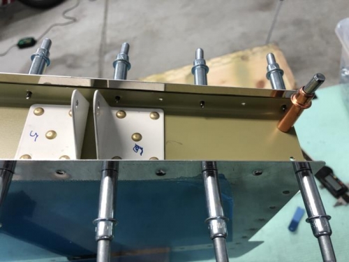

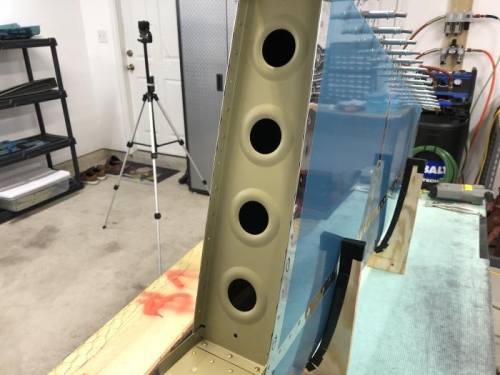

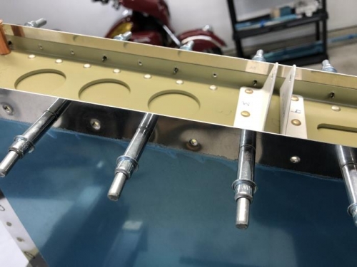

Riveting the rear spar in place. Make sure the 470 rivet heads are aft, this makes riveting the skins in this section easier.
