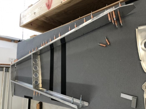

Brief Description:  Fitting Vert Stab Ribs
Deburred and used a scotch brite pad on the dremel to prepare the surfaces for primer. Test fitting all the pieces together and straightening the ribs.

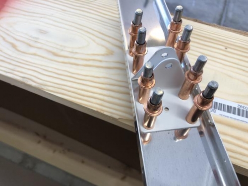

Drilled the #12 holes in the hinge points of the rudder hinges. This was to resize after the powder coating.
Rudder hinge
Rudder hinge

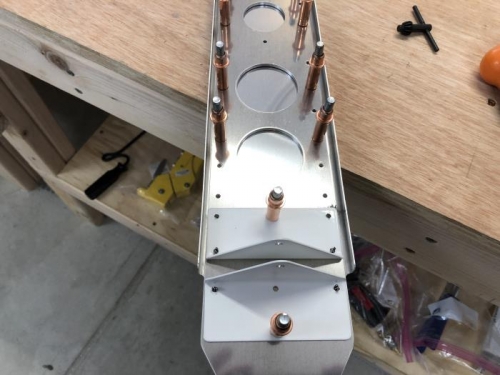

Rudder substructure
Rudder substructure
