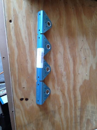

Brief Description:  Assembled Lower and upper hinge assembly
1. Separated, deburred, scuffed VS-1210,
2. Separated, deburred, scuffed VS-1211A and B marked upper and lower.
3. Primed with AkzoNobel 463-12-8.
4. Assembled components using (AN470AD4-7) rivets and bearings (COM-3-5) using a main squeeze hand squeezer.
