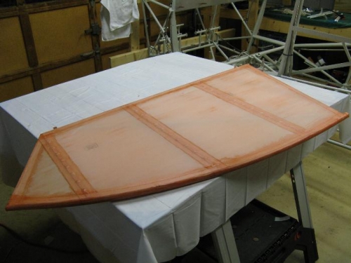

Brief Description:  Covered rt horizontal stabilizer
I'm using the PolyFiber method for covering. I'm starting with the control surfaces. This piece still needs two coats of Poly Brush and two coats of Poly Spray but I'm going to wait until I have more pieces finished to spray. Then I can get these pieces to the airport and open up some more work space in the garage.
