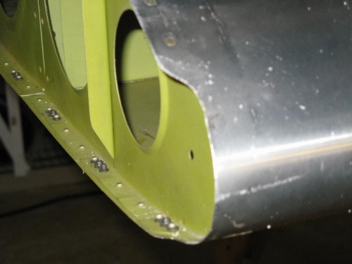

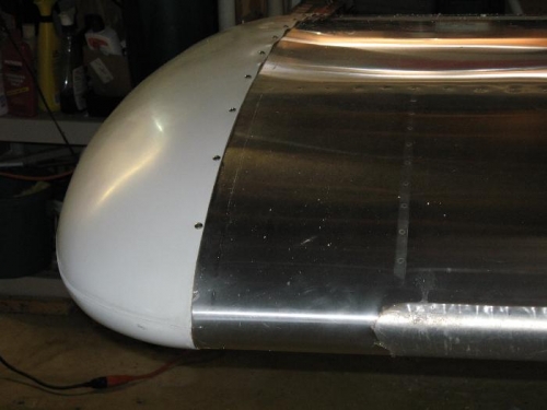

The wing tips stick out a bit right at the front due to the natural curve of the wing tip. Trimming back the leading edge skin as shown in picture #1 will allow the wing tips to fit much better at the front.
