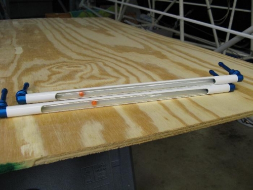

Brief Description:  Sight gages

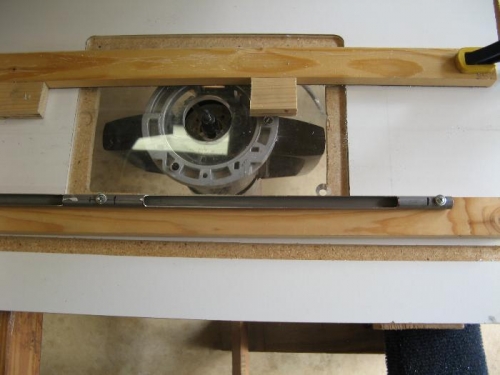

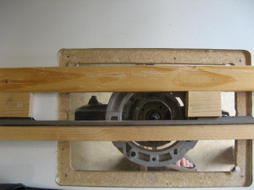

Using instructions from a fellow BH builder I fabricated sight gages from AL tubing. I used a router to cut away at part of the tubing. Polyurethane tubing is run through the AL tube. Polyurethane tubing wont turn yellow with contact with fuel. The orange ball will make the fuel level more visible.
finished product
finished product
