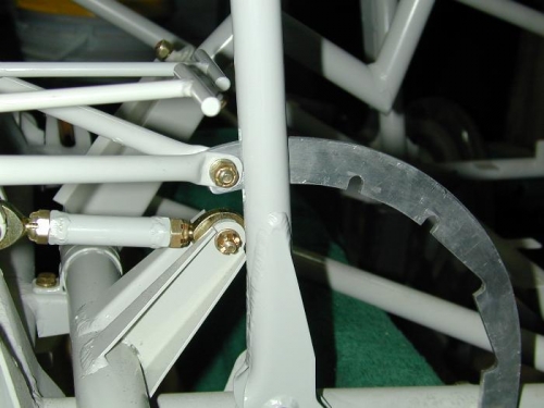

Brief Description:  Seat track/flap handle
Today I finsihed up the seats by drilling the bottom of the seat slide rail. Next I installed the flap handle. The flap handle will not lock into the last notch due to interference from the bracket that holds the curved piece of aluminum. I'll have to make some adjustments to the mounting to correct this. I installed turnbuckles and tied 1/8" nylon rope to the elevator bellcrank and to the flap handle and ran them through the pulleys to check for proper cable clearance. The elevator has some adjustability from side to side to give clearance from the flap cable. Now that it's proper location has been determined I have to make a couple of spacers for the elevator bellcrank pivot to hold it in it's propler location.
Flap handle
Flap handle
