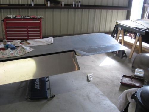

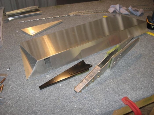

I finished the right aileron and balanced it. I added a washer to each of the bolts holding the weight to get it to balance perfect. Then I installed it on the plane. I installed the left flap then spent a little time trying to adjust them both. Something is keeping them from getting up all the way. Maybe interference on the rod ends. Pretty close .. looks ok with the naked eye but when you measure them ... not quite. I'll work with them when I get the other aileron done and start aligning everything.
I then started making the parts for the left aileron.
