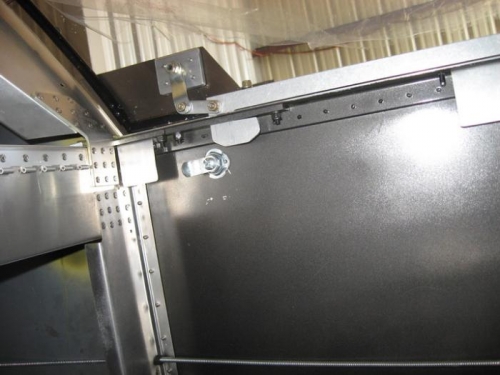

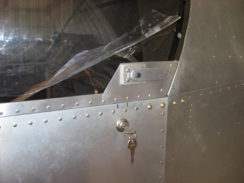

I finished my latch I fabricated and finished the canopy. The latch and lock work nice .. way better than that bar sticking out the side to slide.
I also worked on some misc things ... installed the fairlead bushings (F25) .. hadn't done that yet .. drilled and clecoed the forward and aft push rod support assemblies (C06).
