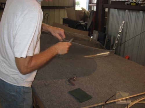

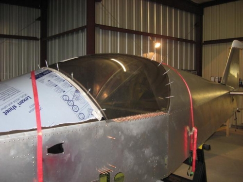

Continued work on the canopy. I think I've had it on and off the plane about 25 times. It's just a slow, tedious process .. but I want it right. I pilot drilled the bows and sides. So far it's fitting pretty good. I was going to start tapping the bows .. but don't have a chuck/holder small enough for the 6-32 tap. Have to figure out something.
