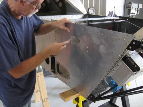

Brief Description:  More foreward fuselage stuff

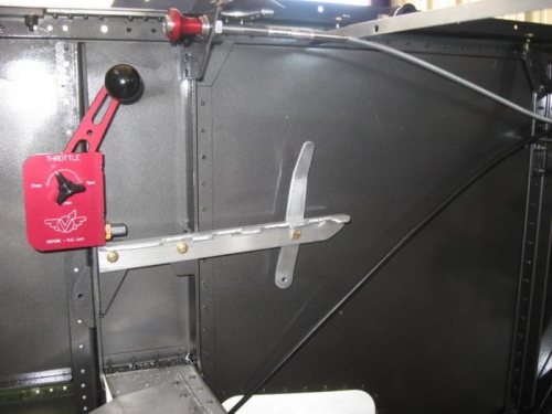

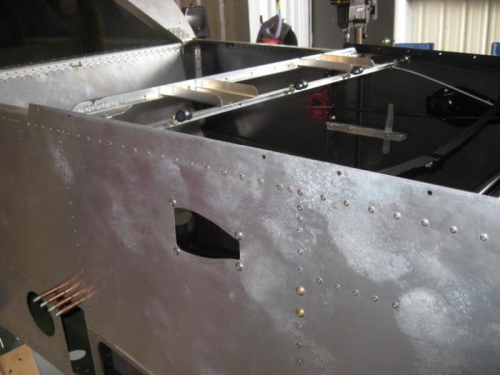

Finished making new flap detent angle with more notches and added the trim lever to it. This will get the trim lever forward of the interior side panel I got from Sonex. I don't want to have to cut it up.
I worked on the fresh air vent system. I'll put the eyeballs under the instrument panel on each side. I added a couple pieces of channel to mount the eyeballs to that will do double duty as wire carriers.
