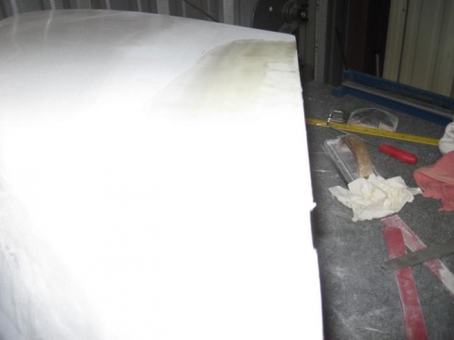

First off I worked on sanding the cowling halves where I'd applied the epoxy mix yesterday.

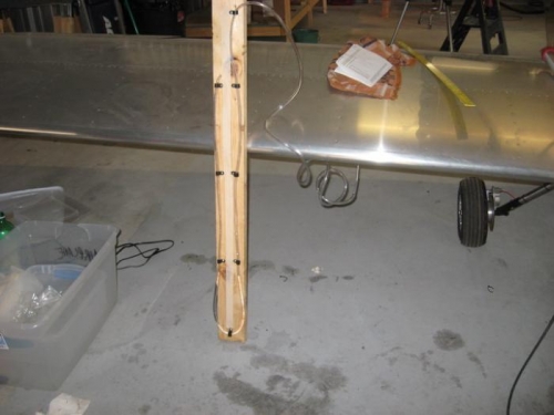

I made a water manometer to verify the ASI. It checked out fine.

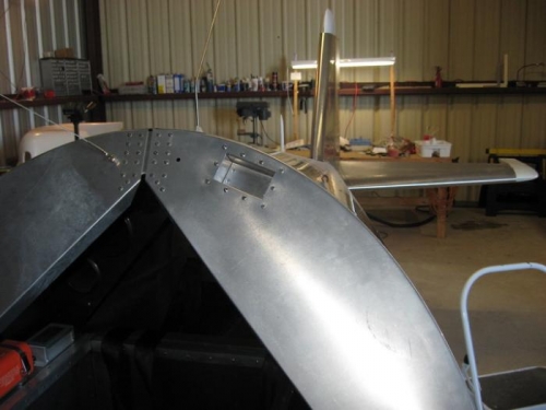

I fabricated a handhold in the front former to make getting up on the wing easier. That along with my step I put on the side will make it nice.
i put another coat of expoxy/microsphere mix on the cowl halves. It's a slow process since I been giving it a day to dry before I sand on it. It's a lot of work but it'll greatly reduce the chances of rivets popping loose the paint over them.
