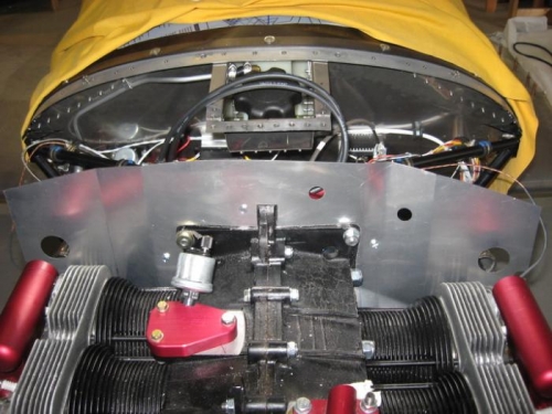

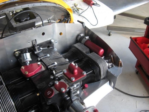

Today was another day of frustration with the baffle kit. I think I'd have been better to save my money and make mockups out of cardbard .. then cut my own.

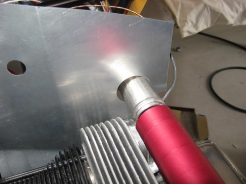

The back panel didn't fit right. On the pilot side the bends in the plans make no sense. The holes are too close together to allow the intake tubes to go thru them .. I had to enlarge them. It's like they measured it without taking the bends into account.
The corner piece on the left front didn't fit after I bent it according to the plan. I finally remade my own, and it fit fine.
Bends in the plans don't work
Holes in wrong place
