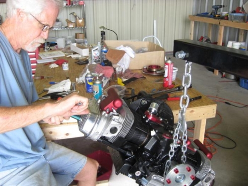

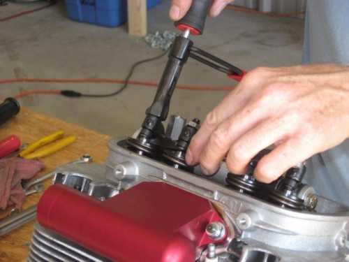

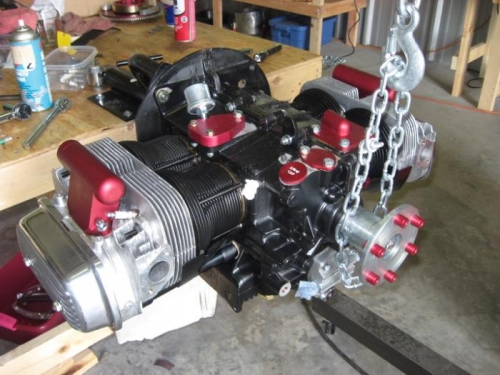

I finished putting the pushrods together for the left side and put the valve train on. Then I adjusted the valves. I repeated the valve adjustment in firing order for both sides just to be sure. I then mounted the valve covers. I had to get slightly longer 8mm bolts for the valve covers because the ones that came with it were too short to get enough threads. It's starting to look like an airplane motor.
