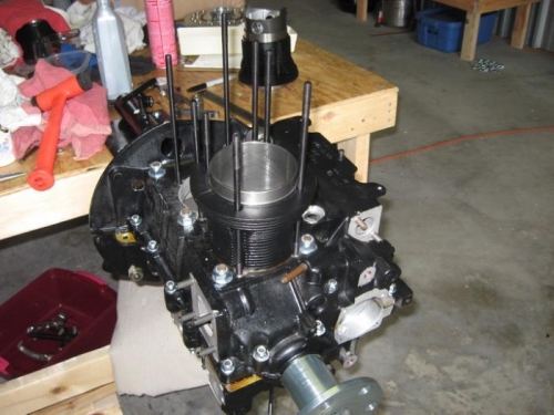

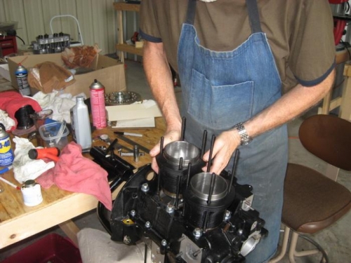

Using the deck height figure from yesterday I figured out what shims to use under the cylinders. I decided to go for a 7.5 to 1 ratio and used a shim number right between those shown in the chart. I'll be running 93 Auto and 100LL. I then mounted the cylinderson the left side using Permatex 3H to seal the shims.
