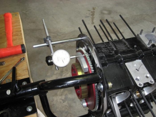

Date:  6-6-2012
Number of Hours:  0.50
Manual Reference:  Aerovee manual
Brief Description:  Check flywheel
Since I had trouble getting the flywheel to fit ... I wanted to verify it was on all the way and was straight. I measured the distance of the pins down in the holes, the pin height, and flywheel depth to make sure it went down all the way. I then used a dial indicator to make sure it was on straight.
