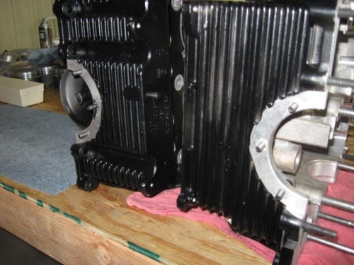

Brief Description:  Studs for machined sump plate
The studs on the sump are shorter than I'd like to see with the machined plate. They only come out the bottom .35 to .40 inches. The screen, gaskets and plate take up .25. I'd like to see a quarter inch inside the nuts. I removed the studs and replaced them with longer ones. Easier to deal with when the engine's apart.
