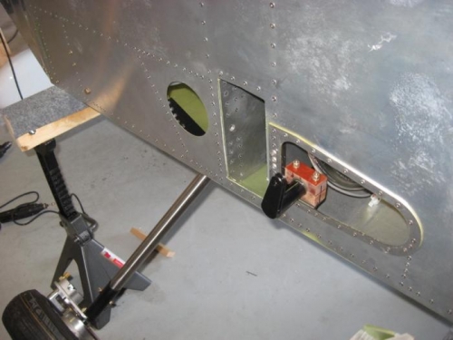

I worked on some misc bundling and tying wiring.
I then finished the flush rivets inside the tunnel. I didn't have enough rivets so one of the guys from the yahoo group dropped some by and
got me going again. Thanks Kirk.
Then I did some fitting of the phenolic blocks and installed the flap drive tube.

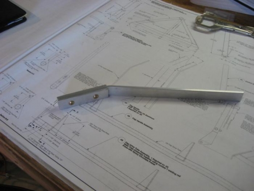

Next I made the flap handle, which I hadn't done yet.
I'll go over everything tomorrow first, but I think I'm ready to permanently install the wings. Progress.
