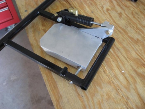

Brief Description:  Brake pedals
More work on brake pedals. The hydraulic brake kit from Great Plains came so finished up putting it all together. I'll do the right pedal when
the airframe kit comes so I have the other rudder pedal bar. I ordered the axels from Tracy O'Brien for the Sonex because they have the full torque plate instead of just one bolt tab to hold them on the wheels.
