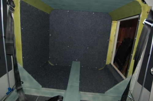

During the last days, I covered the cargo ares panels with a grey felt. I still have to paint the top corners for the finishing touch.
I reclaced the flap controler by a simple ''up-down'' switch. Simpler,, less wires and less potential problem.

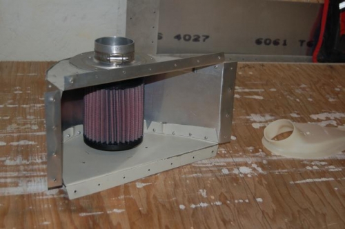

I reinstalled the cowling to measure and build a fresh air intake for the Rotax. The 912ULS with the airbox need cool air to develop its full power. I built a box that will be riveted on inside the cowling right side with a naca scoop
