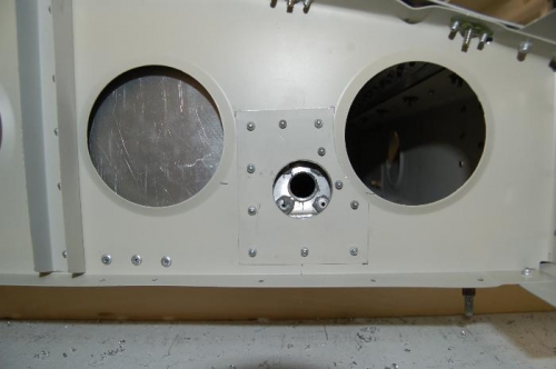

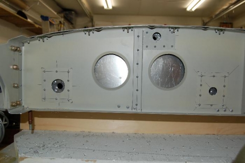

Brief Description: Complete fuel tank installation
Since I enlarge the holes on rib #1 for the tank fitting, I had to put some doublers to keep the rib strong enough. I did 4 doublers with the hole at the right place that I rivetted on the rib.
Positionned the strobe light with the special 45 degree adaptor. To screw this adaptor in place, I had to put a small block of wood inside the wing tip and fix it with fiberglass mat and resin.
