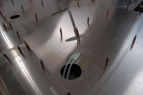

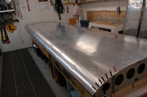

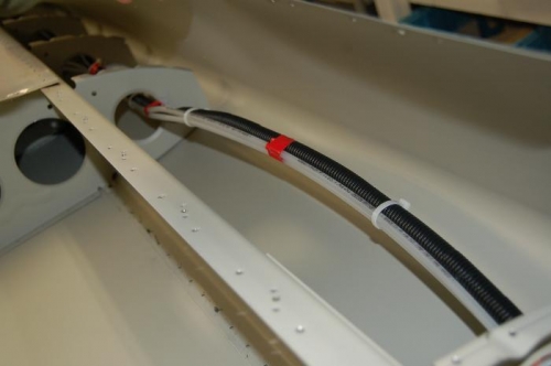

I spent about 12 hours over the last week doing different little things on the left wings. Installed nut plates for the inspection hole covers. Route the strobe light wire harness.Drill the hole for the pitot and route the tubings for it. I used POLY-FLO 1/4'' OD tubing and NYLO fitting.
Also reinstalled the nose skin and rivet the top side. I'll do the bottom side when I'll flip the wing.
