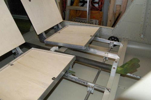

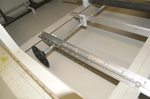

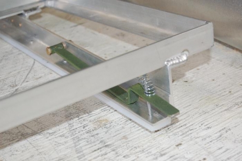

I worked several hours during the past week to finish the seats. It look simple to build but we must be carefull if we want the seats to slide easy and the latch adjustmentmust work free. That would be great to have the seat rail a little bit wider because every holes and rivets are on the edge. But it came out perfect. I can now go on with the controls.
