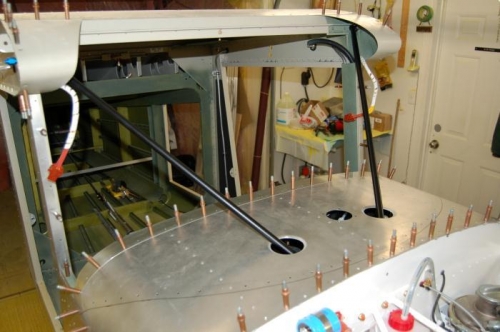

Today I riveted the glare shield in place. I first install the 2 force rods that connect between the firewall and the cabin roof, then riveted the 2 false wing tips in place. I add a strip of aluminium on the glare shield that extend about 1 inch over the instrument panel to form a lip. I like the look.
This was the last major step in the cabin construction. I'm now working on the interior side panels.
glare shield clecoed
glare shield riveted
glare shield extend about 1 inch over the instrument panel
