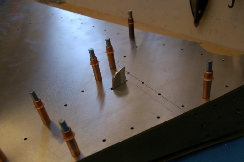

Worked on rudder march 5,6,7,8th. Mount redder parts together. cut the skin to proper dimension. spent a lot of time on PC-65, PC-66 and PC-67. I had to shift the horn position a little bit higher in order to get enough material to drill in. Cut a slot into the skin for the horn bracket PC-67. Finally install everything in the wood jig and rivet one side. Leave the other side with cleco for the precover inspection.
