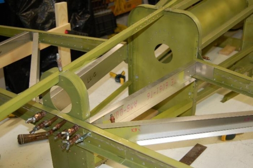

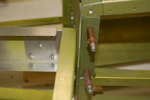

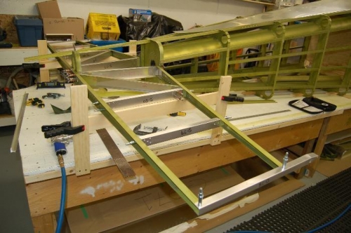

Today I positioned and drilled D75. I followed the instruction ie 290 mm from the table and I assume that it should go flush with PA-06. Unfortunitely, I was wrong. I have read the tip no.9 on Don's web site too late. We must use PD-77 and set it between the two spars D89 and D90 to get the right distance. I'm actually 3mm off
