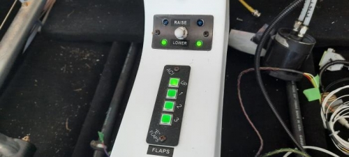

Back on November 4, 2023 I noted that the landing gear green lights were not both working properly and the tail wheel was not always coming up when it should.
When I did the fuel flow test on May 4, 2024 I fixed the tail wheel problem by adjusting the bolts on the plates that the extended wheel comes up against and lubricated everything in sight.

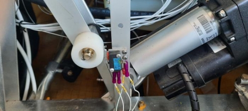

Now, to fix the reluctant green light I just glued a piece of hard plastic (red in the photo) onto the contact button of the limit switch so that it activated earlier than before. Success there too!
Limit switch for green light activation
Two green lights operating
