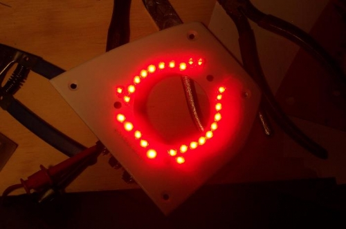

Brief Description:  Finished nav light circuit work
Finished nav light LED solder work. Circuits are built and work great. I was missing one current regulator and will add that when it arrives. The lights pull 0.4 amps each. They are very bright and at 1.2 amps for all wing tip nav lights, its not too bad.
