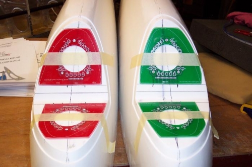

Brief Description:  Started preping the wing tip lights

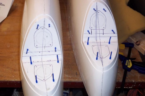

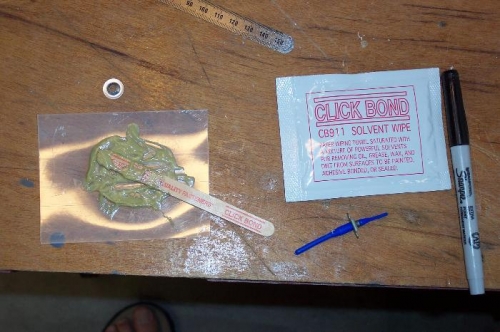

Started working with the creativair light kits that I bought. The tips will have strobes and taxi lights. At oshkosh I I found a vendor named "clickbond". They have a neat product for installing nutpates in areas that are not condusive to riveting. It was a perfect application for the clickbond product. My wingtips were in storage and warped slightly. I talked to vans and they recommended a little heat and reshaping. This seems to work pretty well. The final verdict will be when I attach the tips to the wing.
Laid out the light location
Mixing up the clickbond adhesive
