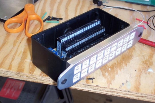

Brief Description:  Annuciator terminal block construction (cont)

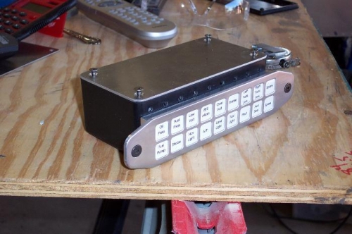

Spent significant time working on the terminal box and attaching it to the light bar. This involved a lot of match drilling, tapping and general custom fitup work. It turned out pretty nice. I am still waiting for some 5mm LEDs to try them out. It was built for 3mm LEDs but these are not quite bright enough.

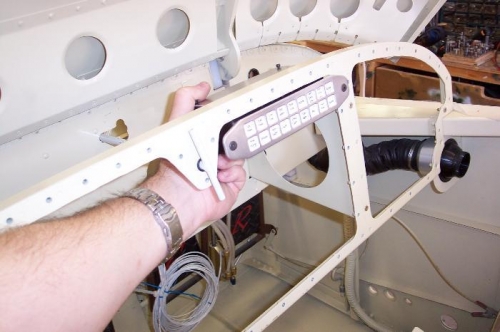

Not knowing if I will mount it high or low on the panel and also not knowing what instruments will be adjacent to it I made the unit so the box can mount high or low.
Total hours = 1802.5
View without the cover.
Final product
Final product
It will look good on the panel
