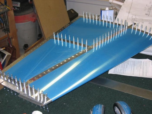

Cleco'd the vertical stabilizer spar and riveted the assembly. Riveted the VS ribs to the forward VS spar. Cleco'd on the skin and riveted the skin to the forward spar and ribs. Finally, cleco's the rear spar to the assembly and squeezed the last of the rivets. The VS is now complete.
1/2 way through riveting the skin
